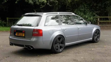

Your old RS6 sounds like a weapon.

It was, sounded class but I don’t miss the bills
