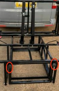

I had a similar issue. Found at the rear access the frame was missing a plastic buffer insert on the frame. Also check the seat belt plastic housing underneath the bed. These had come unfixed and were causing the rattling. All sorted and silent now
Many thanks SAF 1981, any chance you could post a photo of the plastic buffer as ours don't seem to have any.

That’s not right, the lever should be all the way down & the bolt should be at the top of the slot. Note the foam packing that our converter fitted to reduce the rattling.14973F7B-A257-44CB-989F-E02A7E0B839A.jpeg
The brakes are adjusted by slacking off the lock nuts & winding the screws out using an Allen key, then tightening the lock nuts. What can happen, is that the mushroom shaped cam can come unscrewed from the bottom of the operating rod. If this happens, roll the bed to the slot in the rails, lift the bed so the runner is clear of the rail & replace the cam onto the bottom of the operating rod. This happened to me & I put a dab of loctite on the retaining screw.
