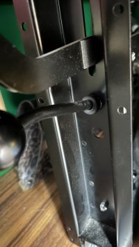

This was the area my rattle was coming from:
Initially I thought it was the pivot bolt for the off-set swivel mechanism (red ring), but actually it’s probably the spring-loaded sliding bolts / lugs that hold the seat squab in position (green arrow):View attachment 218772
Push them and the seat squab lifts off the furry off-set pivot arm.
Mine rattled when I wiggled it once loose:
Take the material off the foam of the seat squab and you can release the sliding lug and tape / pad it:
