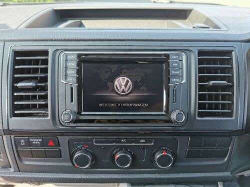

Hi all
My head unit in my t6 when you try and use the sat nav will not let you put certain letters in even tho they are highlighted to be used.
Does not matter how many times you touch the screen it will not select the letter you want but some letters do work on the screen but not the ones you need.
Any ideas on who would fix it or would I have to get a new one ?
Sorry for the long story
Have added a picture of my head unit
Sounds like the touch screen is on the way out, there’s a thread on here how to replace it, I did a mates, £15 for a new one
