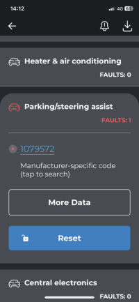

Started the van the other week and had the message on infotainment system show park assist not available and screen not showing anything from rear sensors. When I start up it beeps continuously for about 3 seconds then goes off and again nothing from the rear sensors. It’s a DSG T6. I plugged in Carista and had error code 1079572. Not sure if it’s a coincidence, but this happened last week when it was freezing cold. Have booked it in to VW, but would like an idea of what the problem could be. Thanks.
It could be 1 or more if the actual sensors have failed (had this on my wife’s Tiguan & it stopped the infotainment working) if you put it in reverse and kneel down next to the sensors individually if they are working they should make a ticking noise.
Did mine today - this code is rear right sensor, took 10 minutes to swap out. £12 on eBay, the part number was 5q0919275b for my 2015. I tried the ticking noise approach - it didn’t work for me!
