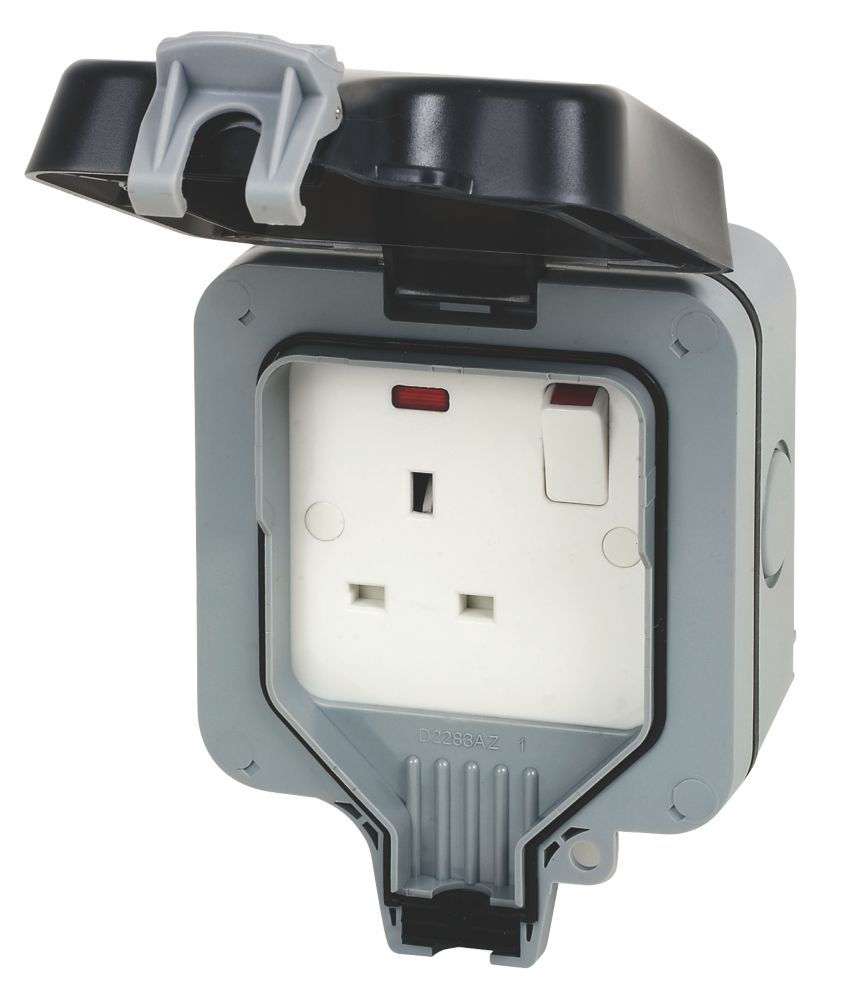

You can fit an external hook up socket to the outside fed from a fused spur. I will get you some pics of mine.
I’ve installed a ip rated 13a socket outlet near where the van is parked. I’m lucky as my consumer unit is in my garage. Look inside for a socket which is closest to the van outside and should just be a case of drilling straight out the back from inside out. Not everyone’s cup of tea to try but a electrician shouldn’t charge you the earth for that.
Here is ours fed from a socket on the otherside via a fused switch. Can pick them up at screwfix or similar

Thank you for all the replies. I am attempting to get Dad to put in an external socket like suggested above.
Sounds promising. He is away to ask mum if there are finances available.

I’d try and just get a normal socket.. has far more uses for outside jobs. Then you can get/make a 13a to 16a commando converter. Just a suggestion :thumbsup: if the hook up serves you better go for it.
sorry to state obvious but get a blue plug, 3 pin or whatever that is backed up with a tested rcd. hate screwfix for this reason they sell and have no idea what part is going to be used for........
They sell you the parts it’s on you to make sure they are installed safe.
