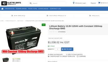

this the battery?:
that battery lists . . .
nomial voltage 12.8v
max charge voltage 14.2v
lowest voltage 11.8v
and the book shows, , ,
Float @ 3.4-3.45v/cell - assuming 4cell is 13.6v
Equalization
@ 3.5-3.6v/cell - assuming 4cell is 14v - 14.4v (14.2v)
The battery is in float, because the charger is supplying all the load, so the battery is sat doing nothing. If you put a bigger load onto the battery greater than 15A then the battery will start contributing & the charger will go into bulk mode.

this the battery?:
Equalization
Thanks for that...yes that is the battery...and all those perimeters are the same as the charger settings. the battery monitor is the Victron BMV 712 Smart. How far does the battery have to drop before new charge cycle starts.? I have been warned not to let battery go below 20%.

this the battery?:
Equalization

this the battery?:
Equalization

this the battery?:
Equalization

this the battery?:
Equalization
