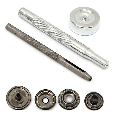

It sounds to me like the fasteners are not quite pressed together tight enough.
It’s easy to tighten them up with a punch / die kit like this
OR make do with a centre punch / pin punch and a cloth pad.
