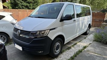

Hi guys, I'm looking for buying a T6 kombi (this is how it's called in my area when you have windows and seats all around but otherwise nothing else in the van). I have checked one with the help of my friends VCDS and have some trouble analyzing the auto-scan logs. Could you (maybe @mmi especially ) help me out so I better know what to expect form this van? It is generally a good condition one, not overpriced would buy it and even spend on it if needed but huge issues would be no-go obviously.
Here's the auto-scan log:
So, some DTCs are around the 245413km ODO and that's when the last oil service was made on the car and it's also suspected that the battery was weak thereabout as the van is not being used since February.
The seller allowed us to delete the codes so we see what comes back. Only P046C came back before starting the van and nothing else during the test drive. It feels and drives smooth for as much as I can feel with my a** sensors but that's more to it.
Even more info: EGR was said to be replaced a while ago (20-30k back) but I have no document about it. Turbo was not touched as far as I know.
We focused so much on trying to get the injectors deviation in engine 13 measuring block (which we could not as this van hasd only advanced measurements menu active in VCDS and I couldn't find any live data with mg/stroke amounts that I forgot to check oil mass in DPF and maybe some other valuable data. The van is quite far from me, repeated measurement is not possible at this point, unfortunately.
One more thing, this is the "weak" CXG engine with the 5spd gearbox but the owner has the CXH(?) (so the 140/150PS one) programme loaded on it as the two engines are said to be different only SW wise, HW should be the same (apart from the gearboxes) so this wouldn't scare me.
Okay so the particular question is, with having the P046C back should I assume there's another EGR issue is about to come up? VW says to ignore this code when there's nothing else but this van had another codes back 3k before but they've not come back now indeed. Also, do you see much wrong with this van from the autoscan above?
Thanks a million times in advance!
