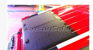

the main thing for long life is to fill in the roof ridges to stop uneven expansion an movenet while its in use getting hot/cold etc . . .
that's what causes then to fail prematurely due to incorrect installation.

i think the main issue is when people fully-seal-all-round which causes air pockets and water ingress that can heat-up in extreme weather and bubble up the panel . . . . . . im hoping by leaving the lower ridges open, and at the rear that this will not be an issue. sealing all rounds seems to make sense . . . but there are loads of YT vids that shows water will 100% end up getting in there.
this should work well. - "then bond twinwall polycarbonate strips on to fill the gaps/ridges. "
remembering to seal the front and sides and leave the back/rear open for ventilation and draining

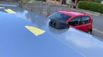

I’m in the process of doing exactly this at the moment - Renogy 200w flexible panel but onto a flat Reimo pop top rather than one with ridges. I’ve used a clear PPF sized about 20cm longer and wider than the panel. My logic for this was to aid removing it if needed, greater surface area and in the unlikely event the leading edge did start lifting I would see it rather than it happening hidden right under the front of the panel.
The PPF is easy to apply with a slip solution made of 1L of water and 2ml of baby shampoo. Spray the clean roof and both sides of PPF, apply film, align it and squeegee out from the centre. Leave to bond for a day or two. Done.
I wouldn’t sand the film or panel, but just lightly dull the surface with a scouring pad then clean.
I’ve decided to use Sikaflex 554 after lots of research. I wanted to use VHB as it would be cleaner to work with but difficult to get a decent gap underneath without doubling up or adding a spacer of some kind. Sikaflex will allow me to easily get a 4mm gap to provide a degree of airflow and allow for expansion. 554 seemed the best compromise for strength, flexibility, longevity etc.
I’ve applied the PPF and cable gland and just waiting for a good day to stick the panel on. Hopefully tomorrow!
You can just see the rear edge of the PPF in the pic.
