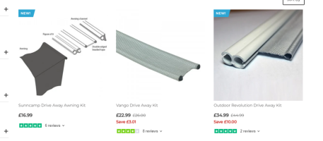

Fig 8 drive away kit,
and Kador strip is most popular. 6mm-6mm
I have the vango drive away kit as pictured above with the Kador strip. I'd seen a few folk mention the pole and clamp method was easier than inserting the kador strip each time and wondered what awning rail you needed to clamp the pole in. I have the standard Funky Leisure awning rail as shown in the picture. The other picture is what I'm considering to get instead of using the Kador strip. Although the pole and clamp does seem to be for older campers that had a deeper gutter.
