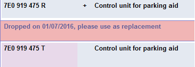

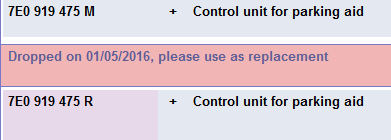

If a Part No, ie: 7EO 919 475 M, needs replacing does the new part need the exact same Part No, or can the end letter be different?
i‘ve seen 7EO 919 475 T and 7EO 919 475 K for sale are these compatible?
maybe @Pauly or someone else with part no guru status may know?
For this specific example - I guess they are interchangeable - based on data on IFI CP2 Message
But then e.g. 7E0 919 475 L or N definitely are not - because of different functionality (8 channels instead of 4 in the examples).

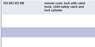

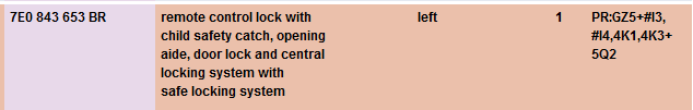

I'm afraid not. Can't assume part interchangeability or supersession on (any logic on) part number lettering. Need to verify from parts database.
An example of a listed part - AQ is superseded by BJ
7E0843653BR
Has not been superseded
and does not have the same functionality as
