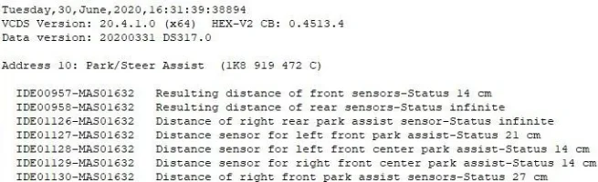

Could you please do full Auto-Scan and post (at least) section 10. The actual fault code + google is quite often very useful. Along the fault code there usually is a "snapshot" of several parameters at the moment of failure - which sometimes gives more clues.
You probably have cleaned the sensor and checked for stone chips etc.
You could park the van against a wall and see what (if any) readings the sensor gives. E.g.
