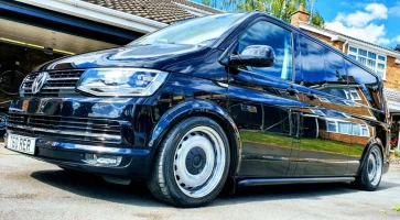

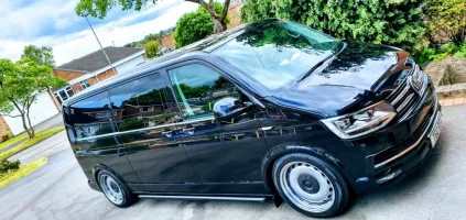

Well, collected the van earlier and i'm pleasantly surprised to say the Parkway VW Leicester have done a sterling job of my van, and I had no reason what so ever to worry. The bodyshop manager Calvin listened to everything I requested, and followed this to the letter.
I dropped off the van and left 2 strict instructions, first one being obviously don't wash it afterwards, which they didn't :)
Second instruction was a first for them and a rather odd one. I requested that how ever the paint came out the gun, was how I wanted the van leaving. This meant any crap in the paint, any orange peel finish, and all the normal finishes people often don't see when having paintwork done, because it's all removed in a fashion, were all apparent. The reason for this oddness is simply because the majority of the van has already been flatted and polished by me, and getting them to try and replicate this finish would take more time than they'd be allowed, so i'd just rather do this finishing work myself. My main concern was getting the colour match right, and that is 100% spot on. I've just done a little fettling this afternoon, but not a full job, because I want to give the paint time to cure before wet-flatting and polishing. I noticed that who ever did my paintwork, also spent the time to go around the van and touch up any chips, which was way above my expectations, and a nice bonus. Plus they replaced both of the rear arch protection clear vinyls.
Overall i'm extremely satisfied with Parkway Leicesters work, and cannot thank Calvin enough for the help and advice he's given me throughout this whole process.
I'm more than happy for anyone that's going through this now, to help out where I can. It's a long drawn out road, but worth the effort.
Although the quality of the finish isn't obvious on these pictures from today, it is more than obvious that for a vehicle that's just had both sliding doors painted, and both rear quarters, the match is impossible to fault.
