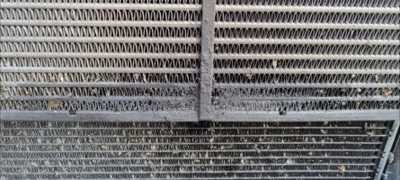

Anyone had this issue, I'm planning to remove the bumper tomorrow to have a proper look at the intercooler but looking through it I can't see anything wrong with the intercooler so far.

I helped friend of mine to get it replaced on his T5.1 .
He had the same fault code.
Screenshot_20230415_115649_Photos.jpgScreenshot_20230415_115654_Photos.jpgScreenshot_20230415_115659_Photos.jpg

Mine did exactly the same so I bought a Darkside Developments one now all is good

I noticed when installing the new one is the same crap quality like the OEM so I'm expecting it to fail again.
