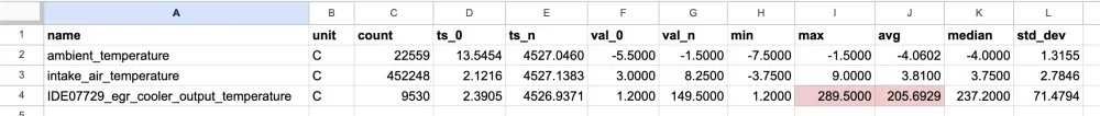

I don't think there's an unambiguous answer to this. EGR valve and cooler on/off switching are used to adjust intake air temperature - for example here's a 1h 15min drive in a freezing (average -4°C) temperature where EGR output temperature peaked at almost 300°C and even averaged at 200°C. The intake air temperature averaged at +3.8°C - clearly above ambient but still relatively cool. Presumably the amount of fresh air is much larger than what gets recirculated through EGR so that's why the mixture temperature stays low but above freezing.
On other occasions EGR output temperature has been seen staying at relatively modest temperatures even on long drives - because the recirculated exhaust gases are actually run through the EGR cooler:
I think the EGR pipe temperature should be relatively close to the output temperature measured here, perhaps little bit lower. But the point is that there's pretty wild variations in the EGR output temperature depending on the ambient temperature and probably some other factors as well.
