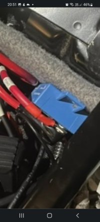

Post a few pics of your set-up.
Not the prettiest but worked so far. Just tried the old ‘switch off the isolator and switch on again’ and all working again. Voltage reading is only 11.9 but am still hooked up to mains so should be charging still thru there?40F51A74-D2D0-475D-BB61-404DBDF1E4DE.jpeg3FDFA098-1B20-4F2D-81E6-C03AC6CD58E0.jpeg

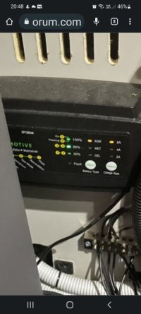

Can you get a photo of all of your mains charger ?

That looks like it there @Pete C
8A job, on AGM profile.
If the fridge is drawing 6A and the battery is low...........and the lights and USB are on.
We're going to end up with a flat battery.
Also worth noting there is a Victron low volt battery protect....
That shuts the power off to save a low battery.....
Thats most likely what happened...
The Victron shut off the power .... Due to a slowly run down battery.
The off/on reset would have reset the Victron.
It looks like to me that he needs to swap out that old EHU 8A charger for a better model.
I'd suggest a 15A Victron IP22 or IP65....
And possiblity a new battery......
Or at very least get that one properly tested.
Agreed. I was hoping to see all the charger to see if there were any other lights, and exactly what model it is.
Pete
Yup - u got me there. Got all my set up from Rayne. Ditto the battery. Thx for the diagnostic - will try and nurse the van back up thru France and then do as you suggest.
