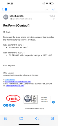

I’ve had a reply from HEL about the thermostats.
Screenshot attached.
It would be helpful to know what the specified / designed working temperature range is, we can then match the stat to suit, even the 92 will off gas & evaporate any fuel or coolant that finds itself in the engine oil.
