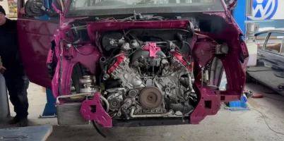

Sure will. I am going to be getting it up in the air on the drive hopefully today. I will take a look at options where to mount the matrix. I was watching this thread on a RS4 into a T5 and noticed their fitment, I am going to look at this as an option

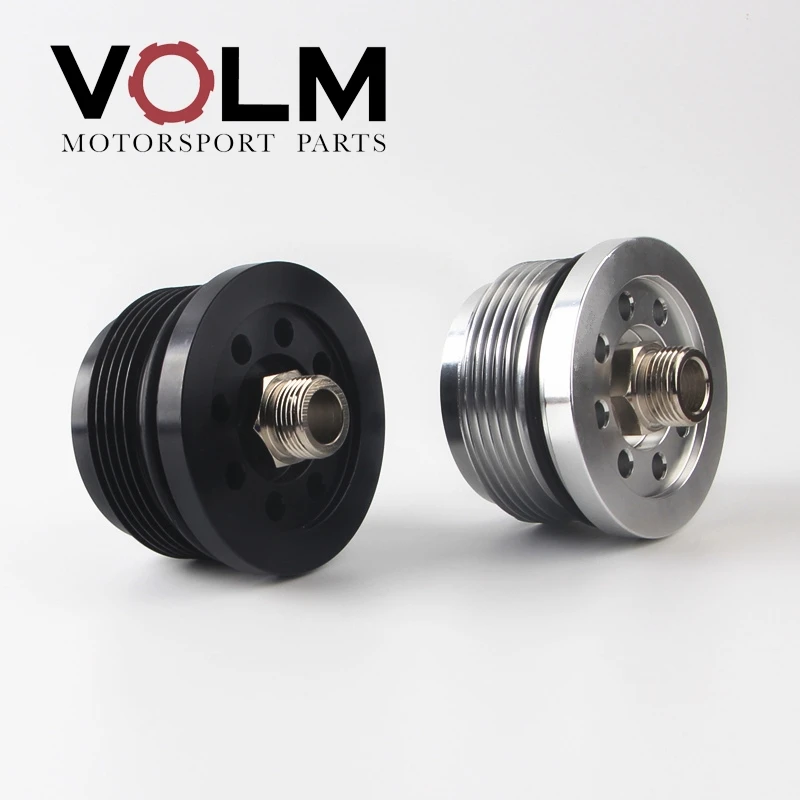

So another way I can think of intercepting the oil flow is with one of the two adapter plates linked below, that will then allow me to use a thermostatically controlled oil filter take off sandwich plate to provide the flow and return for the oil cooler.
Oil filter adapter plate - eBay
The only other way would be to fit a remote online thermostat, which would probably be the best way to go.

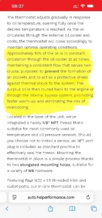

One thing that I’ve always been concerned about it is thermal shock, if in winter, the van is happily operating at 100 C outside ambient is 0 C, then we climb a hill which increases the oil temp to 110 C the stat will open allowing very cold oil into the system, I know the stat won’t just open like a solenoid, so hopefully it will open slowly to allow cold oil into the system.
I think I’ll ask HEL what behaviour characteristics their thermostat has over all three, if the 92 C starts opening at 92 or is it fully open at 92?
I’ve always been told never to put cold oil into a warm or hot engine because of this.
Although I've already denigrated them...
Take of plates of this type to convert Smart cars to spin on filter are less than £15 on AliExpress...
If you were after a thermostatic item etc I'd steer clear, but as a screw in passive adapter these are very good, well machined, and would save a packet. In their day they were very popular with Smart owners and used a few myself (serial W450 owner BITD.)
