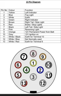

Did you test pin 10 also with engine running or just ignition on? I’ll try to verify from wiring diagrams in a bit which one it should be
Don’t mind the wire colors in above diagram, that was just some generic pinout from google

Yew thats a good point, since i just noticed that the wire colors are completly different. But one thing comes to mind and its that im using a 7pin adaptor, and the pin 9 does not seem to connect to any pins in the outlet of the adapter. The funny thing is that is has worked withe this adapter
Hmm looks like pin 10 might not be connected at all in the socket, these are T5.1 diagrams from 2010 onwards and dated 10.2014, it's definitely different to T6. And if pin 9 is not used by the 13-7 pin adaptor, neither of the live feeds has anything to do with the issue.
