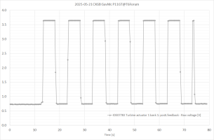

Hi @mmi would you mind checking my log file to make sure all of my numbers stack up? It seems fine to me.
