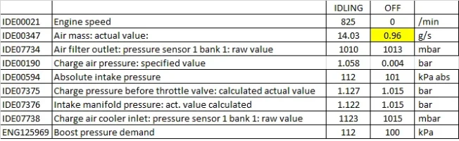

Please post engine blockmap files
1) Ignition ON - engine OFF
2) Engine running at idle
VCDS > Applications > Controller Channel Map >
Tick/fill boxes as above and click Go.
The result files blockmap-01-... will be in folder C:\Ross-Tech\VCDS\Logs\....
Thanks, quite interesting set - because of the decommisioned functions - good amount of money in the now absent sensors.
Can't find anything obvious - except I would have expected to see air mass (IDE00347) to be plain zero engine stopped - not sure if it's critical or even related to the issue - perhaps a MAF sensor clean would change it?
