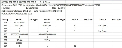

What is the new Measure Block 234 showing in VCDS ? That is the only new thing in D
Wish I knew what they mean...
Interestingly another one has in there values 1, 1, 21. Both were scanned engine running.
Even more interestingly BCM 7E0937090 is then missing groups 230, 231, 232, 233, 234. The BCM was on MY16 T6. :rolleyes:
