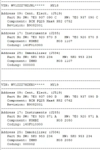

I think i remember.
There was no BCM Adaption Channel involved.
- Put a Key in ignition lock and put ignition on.
- Put other key in Driver Door, Close it with this key mechanically and then pres close on key button, wait 2 sekonds, press again close key button
I think that was it
Other way i found in german internet
is to use Channel 000 and 001 in BCM 09
Set 000 to 0 and save
Set 001 to 0 and save, while it saves press Open on your key which is inserted into ignition. this should be accowlaged by the Lock making Lock noise
Or described in english:
VW Polo DIY: Upgrading the BCM (Body Control Module)
I think that i did 1 year agoe
