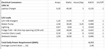

Firstly, as already mentioned, you need to do a power budget for your van.
Mine looks like this (Standard VW California Ocean)...
So I know I need a solar system that will provide 0,7kWh a day reliably, estimate on yield for a solar system based on your location can be found here ...
... I fitted 310W for Southern Germany but after running it for a year, 200W would probably have been fine as any movement of the vehicle also results in charging, e.g. a day trip or a shopping trip.

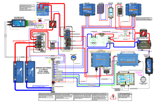

This is an example of a system that would fulfil your needs and could be adapted with components of your choice ...

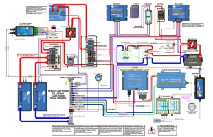

I have a converter-installed lithium power system in my camper (300W solar, MPPT, mains hook-up, B2B charger, 3kW inverter, ~220Ah LB, etc) and it all works extremely well - with a moderate amount of sun and/or the occasional ride out in the van, initial indications are that we can exist off-grid almost indefinitely (during the summer months at least).
That's great and we're really pleased with it, but what I've noticed is that the SB voltage steadily drops if the van isn't driven for a prolonged period - even if the LB has 100% SOC and the sun is blazing down. I presume, therefore, that my system is lacking the kit needed to trickle-charge the SB from the LB.
Given that I'm a complete novice electrical-wise, would you mind listing the components I would need to add in order achieve LB->SB trickle-charging? Also, if you could point-out where on the above diagram these components are, then I can show my converter the diagram and say "how much to supply and fit these, like this" :)).

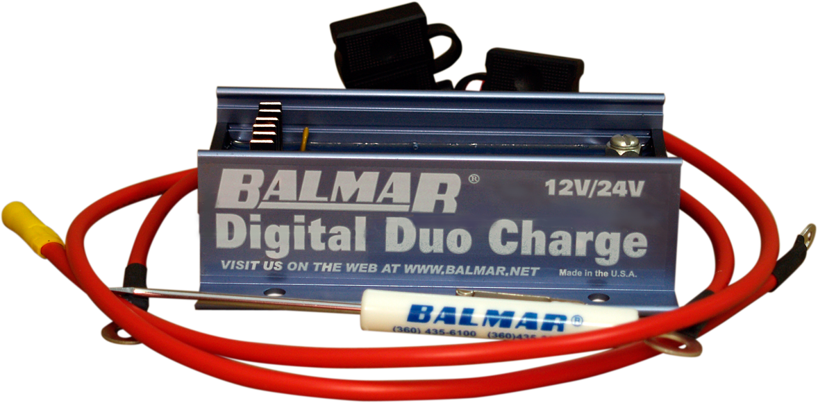

I would fit one of these ...
It will charge your lead acid starter battery with 2,5A or 5A from a Lithium leisure bank while keeping the battery banks isolated.
Sorry it is in Germany, but that is where I live and I couldn't find an english description.

Looks a good solution, there’s also the Ablemail AMT-12 to consider. I have one fitted. Does what it says on the tin.

Hey guys, my converter is suggesting to use of one these...
What do you think? Will this do the same job? Any pros or cons?
