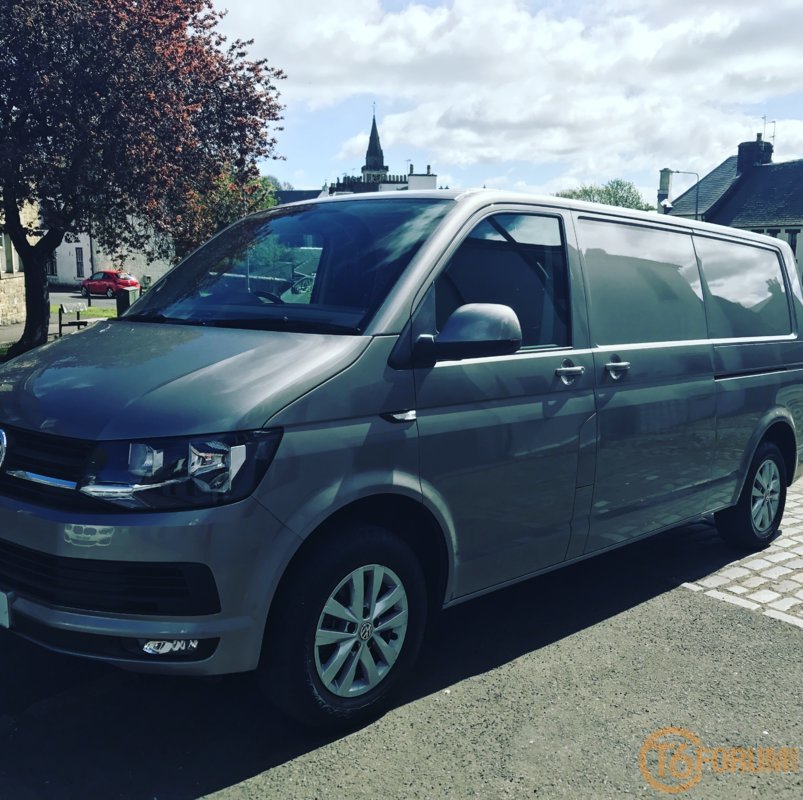

I picked up 'hutch' two weeks ago from a vw centre in Newcastle. He is a 140 highline dsg in mojave. He's got factory fitted tailgate window and nothing else! Conversion will be slow ish due to time away with work and funds.

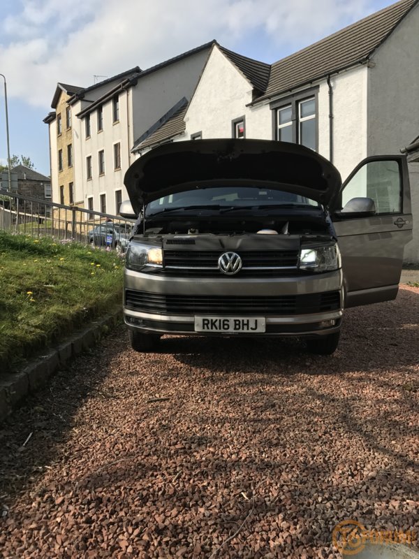

Here he is in lovely, rare, Scottish sun. First mod was led drl's as the yellow ones are pants.
