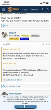

What’s that - coding the van to the LED indicators? If that’s the case then don’t worry, AFAIK the repeater isn’t monitoredHi, sorry for reigniting an old thread but does anyone know if this can be done with OBD11?
Thanks
Yeah possibly.Sorry, I was trying to quote from this post from 2020 (re VCDS coding).
To deactivate indicator PWM the following VCDS coding modification needs to be applied.
09 BCM, (Byte 19, bit 3) = 0 (unticked)
