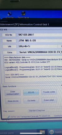

Hi,
I have a 2016 caravelle with composition media retrofitted. I think its patched to remove cp and add functions like carplay, voice control etc. There is nothing under installed swap codes. Today i tried to activate features like car info display with vagcanpro adaptations but only driving school mode activated. Do you have any idea if i can enable them or is it impossible ?
Thank you

I have 478 on my head unit in my Tiguan and I too have a patch that enables everything except CP as factory fitted. Unless you add the FEC/SWAP using a calculator then they will appear as uninstalled. If you look on youtube you will see someone adding features using OBD11 but you have to generate the correct HEX string for your headunit and car. i have managed to enable a few features like bluedrive mode, offroad mode but can't get sport to display even though enabled via VCDS.
I can't say too much as not sure it goes against the forum rules, go searching, you will find info on the web.

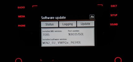

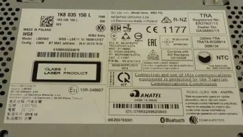

Hey everyone hope you are all well
Im running out of hope that this is possible but got this head unit and was hoping someone knows how to patch or remove CP from i just wanted bluetooth as original unit didnt. Is this even possible?
Thanks
Emily
