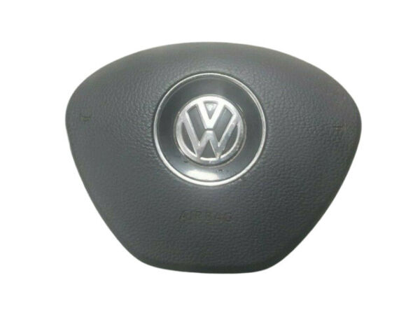

I bought this steering wheel on a whim (it was cheap!) thinking my t6 airbag would fit due to it looking the same shape. A bit more digging suggests otherwise! Can anyone advise if it will fit by looking at it? The wheels from a Polo and hasn't arrived yet so I can't check just yet...

In a word no, I'm afraid. You'd need one with two hooks as in the picture.Screenshot_20210206-110207_eBay.jpg
If you don't have a MFW at present the one you have bought does at least have the correct buttons which will swap over to a wheel with the hooks, as these usually don't have the correct buttons for our vans, good old VW eh!

Think that'll fit the wheel, as to whether it'll wire up to the van is another thing.
Doesn’t look like see attached photo of rear my airbag with NEW Loom for MFSW controls swapped from Trendline plastic wheel onto wheel like you have ordered .. note the 2 airbag located spring loaded retainers above the springs 1612905452583.jpeg

Looks like that's the same wheel I fitted to mine
It's from a polo 6c, you can see the same fittings without the airbag in place
I bought the correct airbag for the wheel and it was plug & play
Got it re trimmed and sold my original wheel to recoup most of the cost
