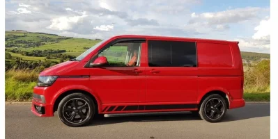

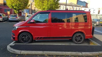

That does look very high
Mine is also a T32 with 18" sportlines
1st photo show it a couple of weeks after 1 bought it, stock suspension
2nd photo shows it with -40mm h&r springs (not a massive difference)
On both photos the van is empty, so yours does look high compared??
Looking very good @Superowls - definitely looks like there is a massive difference

Thanks @Superowls this is really helpful. I’d be really happy with how yours looks in the 2nd picture. That’s a nice looking van, don’t see many reds around.
