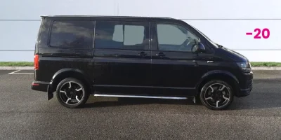

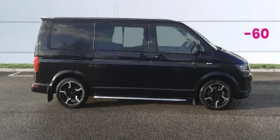

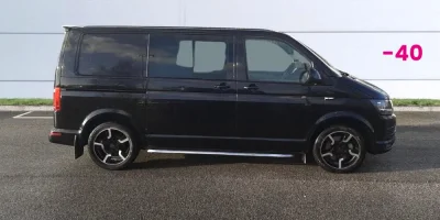

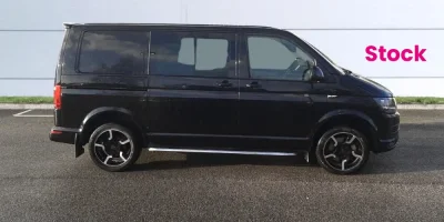

If you’ve got a full side view image I can photoshop the different lowering amounts if you like
Would just need to know the current gap so I can reduce accordingly.

I think in reality your vehicle is sitting at the full height for a T32. As the difference between the pic I put up and yours is clearly more than 30mm, and that van has -30mm springs on it. But that’s a great illustration
You won’t need to go to extremes to get a good stance, if that makes sense

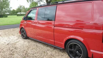

That's our T32 lowered 40mm. Bilstein B14's and 18" Sportlines. Sorry,i can't seem to find any photos of it when it was on Standard suspension but i remember it sitting quite high but perhaps not as high as yours looksIMG_1282.webpIMG_0097.webp
That's our T32 lowered 40mm. Bilstein B14's and 18" Sportlines. Sorry,i can't seem to find any photos of it when it was on Standard suspension but i remember it sitting quite high but perhaps not as high as yours looksView attachment 103695View attachment 103696
Thanks Martin, again that looks really good with just 40mm drop.
