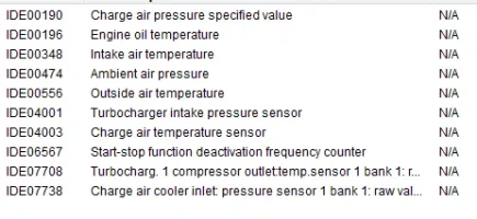

I don't seem to have a charge cooler inlet temp on VCDS, just turbo no.1 compressor outlet temp and charge air temp. I guess the turbo no.1 compressor outlet temp is the same as charge cooler inlet, just the other side of the throttle body. I didn't get out today, but will try tomorrow..
@catfood12 Yes i believe it is the same sensor only after the throttel body.

Air flow sensor at max revs numbers are looking good, as was the boost, Any one know what numbers they get for boost to compare?
2.55 Bar (36 PSI) boost pressure, seems high but I have no idea what the VW specification is.
