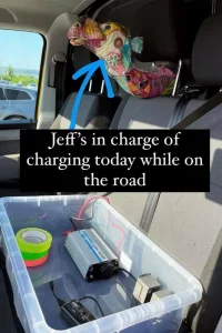

Haven't had time to wire up my big inverter system so testing this little one of the already fitted leisure battery.
It did ok but the fuse blew at the end of the day & I didn't have any that big with me. Luckily just about had enough drone batteries left for the sunrise shots needed the next morning.
