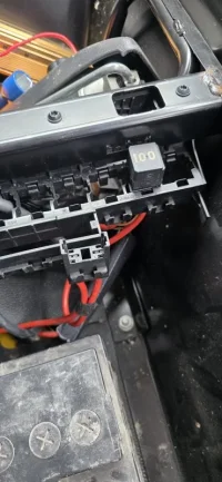

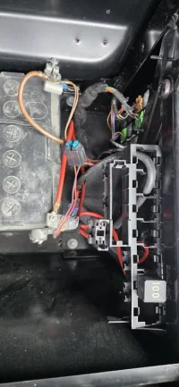

post a few pics and well see what we can see.
What you have there is the OEM factory leisure battery setup.
It's frs from the SA main fuse box under the starter battery.
Via that 100A really, to the missing 50A odd fuse to the battery...
The battery is missing for some reason.?
More info
