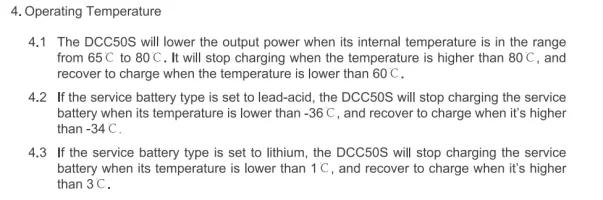

firstly you only need to worry if your Lithium battery is 0degC or BELLOW. . . . . . . and even then, its only the CHARGING that may be an issue, You can discharge the battery bellow 0degC no problem.
you may find it easier to just disable the charging circuit while its very cold? - Switch off or disconnect the solar panel? . . . put a on/off switch inline with the DC-DC ignition feed?
if you still want to take the battery out thats fine, just insulate the remaining battery cables in the battery box. - but remember you are supposed to disconnect the solar panels before removing the battery due to the solar charger, also the DC-DC should be disabled too.

That has a lithium profile WITH Low Temp Disconnect,

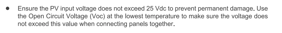

The only downside i see is a 25v max VOC solar input (but you can parallel panels to get around that) (But will be still using the Victron MPPT kit alongside anyway)

Renogy's DCC50S DC to DC MPPT on-board Battery Charger is designed to give you options! This multi-stage, multi-input battery charger can charge a service battery from an alternator connected to a starting battery or by utilizing solar panels connected directly to the unit. While your vehicle's alternator prioritizes your starting battery, this unit will allow your solar system to charge your service battery first! It's the smart way to keep yourself fully charged and off-grid longer! And with multi-stage charging and multi-chemistry functionality, Renogy's DC to DC MPPT Charger has you covered whether you're using Flooded, Gel, AGM, or Lithium batteries.

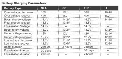

  • Temperature and voltage compensation features prolong battery life and improve system performance.

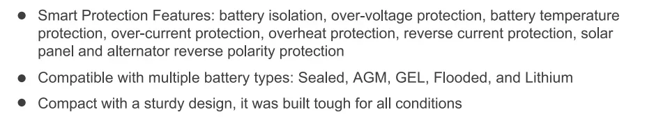

  • Smart Protection Features: battery isolation, over-voltage protection, battery temperature protection, over-current protection, overheat protection, reverse current protection, solar panel and alternator reverse polarity protection.
  • Compatible with multiple battery types: AGM, GEL, Flooded, and Lithium.
