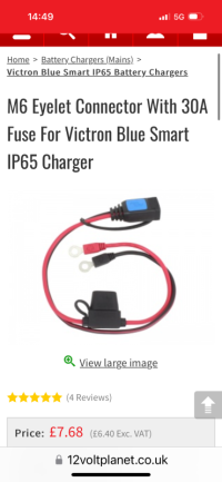

ginkster recommended this lead for the charger so It can be removed.Yeah that would be the best way - just fit a fused lead into your fused busbar with either an Anderson connector or a Victron connector. Then plug the 240v charger into a socket if you need it.
Is it the ip65 or ip22 240v charger you've got coming?
The ip65 has a detachable plug so you can easily connect or disconnect. With the IP22 toys need to make up your own lead.
With no inverter I very much doubt you'll need hook up!
Yep. Disable the existing charger and plug the ip65 into a 240v socket when on EHU. The lead above means you can connect it up permanently to the LB and remove the charger when you want.ginkster recommended this lead for the charger so It can be removed.
The charger is the only thing I’ve not ordered yet but will order the IP65 with the plug.
So pulling the existing charger fuse will be fine for disabling the existing charger and my vans sockets and microwave will still work as normal on EHU?View attachment 255613
