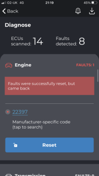

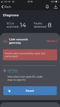

Plugged Carista in and BOOOM loads of faults! Reset some but others keep coming back.

Still got all the same faults.
Took it for a 5 min drive and no change.

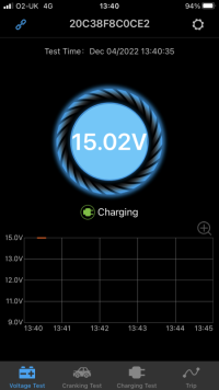

I’ve got a BM2 on the leisure battery and that was sitting at just under 13v before I started the engine. Started the engine and it’s telling me the leisure battery is getting 15v! See attached.
Is this correct?? Image of battery attached.
One thing I did do yesterday was to connect the little red wire from the Ctek to a permanent live rather than an ignition live….. again the BM2 said the leisure battery was getting nearly 15v and the engine wasn’t even running. I assumed it was sorting itself out and left it for ten minutes. Looking back, I don’t suppose the starter battery enjoyed having 15v taken when the engine wasn’t even running!
