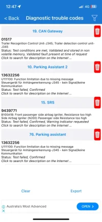

Post install with everything working well on the leisure battery front. However I now have a couple of faults on cam scanner including my park pilot been deactivated.
Anyone know what the faults are, presume I could have damaged a wire on the run or a connector under seat? Have checked all connectors however can not get rid of the trailer recognition - j345 and the 2x park assist u111100 faults.

I’ve just found the trailer module, thanks @roadtripper and no power because I chopped the spare 12v cable under passenger seat into two pieces and took the main 8 mm cable. Turns out this powers the other spare cables and the trailer detector module. Thanks all park pilot works again and all error codes are cleared with a quick splicing of cables but now need to do it properly. Thats a day gone on trouble shooting
