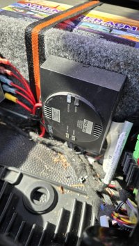

My voltage readings were taken at the AMT connection, so really there’s nothing for the AMT to do at the moment. But flashing red normally suggests a problem, but the voltages say not. I might give Ablemail a call to see what they think.

They replied very quickly when I asked them a question. I’d just try dropping the SB voltage a bit and see if it kicks in. Pretty sure it’ll be fine.

So the Ablemail tech says that the led is likely to be amber rather than red. Apparently, some leds have a weaker green tone which may make the amber look redder than it should. They say that showing amber is consistent with the voltage I have in both batteries.
With talk of this red light malarkey, I thought I should take a look at mine. It's always been set to default setting 4, no issues works perfectly. For some strange reason, what used to be an Amber light is closer to red than amber! The green light is very green though, but in the past 12 months the amber bulb colour has changed!
LB around 13.0v SB around 12.28v. Still love it!
