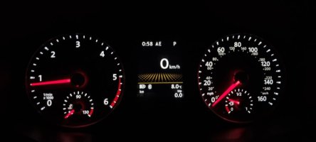

Does the analogue/needle speedometer have scales both in km/h and mph?Hi everyone, just got my T6 Multivan today

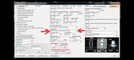

It seems that my cluster (T6, 7E0 920 870 S, LHD, km/h only) follows the theory. Tried the most obvious codings for mph display (UK, USA, Canada, +AUS) - no big digital mph, sticks with km/h display. A kind of interesting by-product was achieved with USA and Canada codings - door open ding-ding... warning - and keeps dinging quite longMy theory is that, IC with analogue speedometer scaled in km/h only are capable to display large km/h only in the centre display.
Countries using metric system by default get vehicles with analog speedometer in km/h only ( obviously disregarding any imports).Does the analogue/needle speedometer have scales both in km/h and mph?
Sorry to drag up an old thread.. I'd pretty much given up on the large KPH display until I was having nosey at @Robert TCS and HDA and noticed this video which shows the large KPH display:
So it is possible just how? I'll have a play tomorrow and see if changing the language does it
Actually this is available to every single T6 owner and no additional hardware is required.Its not available to us, robert is helping in developing a hardware device that expands tweaking capabilities and hes showing off again !
