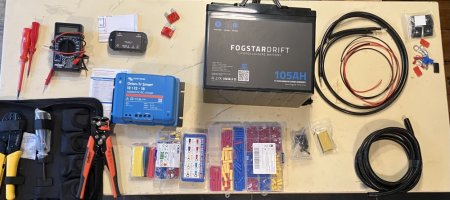

image.webpNeeds obviously cable management sorting but all seems to be in?
Followed instructions to update firmware etc before bridging (green bit).

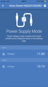

Then attached the ignition wire. And get the following on the app…..
This is all working yes?:)

The electrics will be working as they're running of the new battery - but the DC-DC needs too be in charger mode, not power supply.
Check on the Fogstar app and you should see a few amps going out depending what you've got turned on.
Then, with the DC-DC in charger mode and the correct lithium profile set, start the engine and turn on your lights to force the alternator to provide charge and you should see 18a going into the battery.
