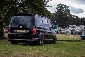

Judds are a great looking wheel particularly in staggered form. I would go 8.5 et35 or 40 front depending on tyre size and 9.5 et35 rear.
Different wheel but to give an idea this is 8.5 et35 front 10 et42 rear. All the way down on B14s also.

One the thing to consider is that if you go for 19" then you are running 45 profile tyre minimum, for correct load rating which is fine, but they aren't exactly rubber band tyres, and the choices are limited. Saying that, i've always run 19s and found them to be a great compromise between looking too big or too small on a Transporter. As for offsets, personally i've run 19s in 8.5 ET45 all round, and I thought they could of done with being pushed out a little further, so the staggered ET35 would be my choice from the above. You can still get away with the same size tyres all round on those sizes and for a T32 that would be 255/45/19.
