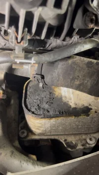

I think I may have a hole in my inlet manifold, I’ve been in the engine bay today to pre oil the fasteners for the EGR removal for cleaning and notices a sooty mess in front of the rad on the coolant hoses and oil cooler sandwich plate

The suspected hole in the manifold turned out to be a split front EGR pipe, rite where it enters the inlet manifold, so that will need replacing, both bolts on the other end of the front pipe sheared off, so it NEEDS to come out now, just not sure if it will go back in or not yet.
