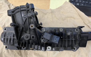

Removed inlet manifold today and replaced with brand new one
Quite different removing bolt behind fuel pump but all done ,like a new van old manifold blocked

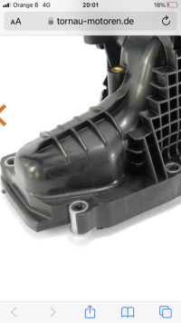

hello, how did you deal with the screw behind the collector? I'm in the process of replacing it and I can't remove this screw
