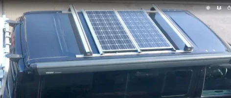

Anyone have a SCA 198? Im looking into finding some rails to fit the roof - if this would work.. and then fitting a plate like this onto which i could fix the panels? im not keen to glue them directly to the roof... Here in Switzerland it gets hot in summer and i would like to try to keep some cooling available to the panels..
Here's my setup on an SCA192. 2 x 100w rigid panels on the roof rails.

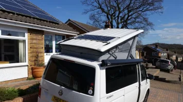

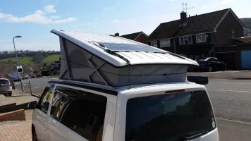

On my previous van I had cables from the top of the panel into a dual entry gland. They faced the direction travel, never had an issue with water coming in. Cables were relatively taught and the glands were fairly close to the panel. There was no slack in the wires that could get caught.
This time I’ve gone for a panel with the connections on the underside. There is a slight bulge in the panel where the cable box is underneath but it’s much neater. The panel then covers where the wires enter the roof.
I’ve also seen panels where the cables exit the top of the panel and are then tucked underneath the panel (in the gap created by the ribs on the roof) then the panel stuck over the top covering where the cables enter the van.
