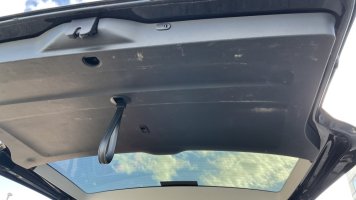

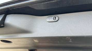

1. To get to the internal switch assembly, I have to remove the plastic internal panel/card from the tailgate. Looking for tips on how to do this (can't find anything on here/youtube).
- Caravelle so seems to look a little different to Transporter tailgate - see photo
- Need to remove surround from 'child lock' switch (looks like 2 pin holes to do so - is this a special tool?) - see photo
- Wanted to check if there is a specific process/knack to this before I start yanking out clips/brackets/breaking things...

This is not an uncommon fault, it is the switch in the external handle that is faulty
The interior release button and the external release handle are wired together and use the same cables to signal the door to release so you know the wiring is good as the internal button is working
To fix it you need to remove the tailgate internal panels and replace the external switch, i cant offer much more help as its not something i have done myself but if you have a search around there are some posts regarding this, i think the replacement part includes the external handle that will require painting but believe this can be separated and doen without changing the external handle ?
@Ads_Essex didnt you do this ?

Thanks, Pauly. Really helpful. Makes total sense.
…appreciate any tips/advice from anyone to remove the inner tailgate panel (including child-lock thing!) described in question 1 above.
Thanks…
I didn’t have this issue (touch wood) but did fit a tailgate soft-touch button - @Duffer if you look on my threads you’ll see a Tailgate conversion thread where I list the parts (and possibly touch on fitting). It’s an easy job once the internal trim panel is off (which I can’t advise, as I don’t have a Caravelle).
Good luck!
If it's any help, I've just taken the lower trim panel off a shuttle and that's a straight pull off - worth prising out the close button from the bottom edge and disconnecting so you not left hanging! The main panel does take some shifting - get some plastic trim tools or kitchen utensils under the edge so you don't get fingers trapped like I did. Oh yes and the pull strap needs to come off too!
Thanks @Ads_Essex & @Steved55.
'straight pull off' it is!!
Side note; the external tailgate release is working very occasionally - guessing this is normal symptom of it being on it's way out...
