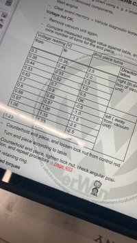

Ok so it’s back on but before I try to fit the circlip the workshop manual is saying to measure voltage via the diagnostic tool. Is this absolutely necessary and if so can vcds do it?
Reactions: mmi
to check the voltage I opened vcds and then the engine controller. I selected output tests and then turbine actuator IDE07783. I figured this out by myself so it might not be correct but the voltage value changed as I operated the actuator with the mityvac gan
IMG_5343.jpegThe N/A value will change as you move the actuator.
fingers crossed I got it right!

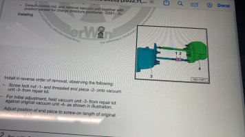

Stuffed some blue rag in the air pipes in readiness for the flying circlips!
But to be fair it wasn’t too bad and I had success with the 2nd one. God knows where the first one went! Trying to keep the mityvac pumped while manoeuvring some long handled pointy nose pliers with a small screwdriver in your third hand is tricky enough especially in a dark space with crap eyesight!

Sorry for the late reply. It was reasonably straightforward once the fault had been diagnosed. @mmi was very helpful in pointing me in the right direction on more than one occasion. You need the vac gun to operate the actuator to remove it and also to calibrate the new one. Worth buying one as they are very handy for other jobs such as bleeding brakes etc. also worth becoming a member so you can download the workshop manual. I’ve got an old laptop in the workshop loaded with the manual so it’s easy to refer to. I then use my day to day laptop for vcds.
