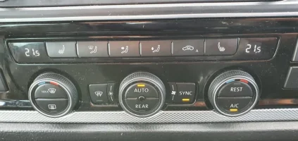

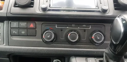

But I want to control it via the climatronic panel over CAN
(You can just make it out on this pic)
as mine is a T5.1 I have a slightly different climatronic panel which I have fitted the heated screen button to from another panel (all pcb components all seem to be present) but just doesn’t function

But I want to control it via the climatronic panel over CAN(You can just make it out on this pic)
