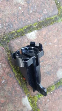

Following on from @Ed Webb 's post and picture above. This is what the rest of the component that he circled in red looks like once it's out. It's almost like a built in tool to turn the bulb holder with. And said tool is just a press fit on the holder, so it can detach if you just pull it. Best make sure you've turned it anti clockwise first, before trying to withdraw it. Its stiff, but it does turn just a little. There's no wires to detach from the bulb. The contacts are built into the holder.
As for getting it back in, well you look a proper pillock with your face mashed against the side of the headlight. Was the only way I could see through to the hole to locate the bulb, as the lense shaping distorts your focus.
Anyway, best of British to you, if you have need to get these suckers out/in.....for what ever reason. :cautious:
