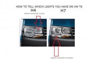

Finally when trying to determine if a light for sale is H7 just look at the main and dipped beam reflector. In H7's the reflectors are the same height and have an extra lens next to the indicator lens (DLR). H4's have a larger reflector on the outside (dipped) than the main beam. Hope this helps.
